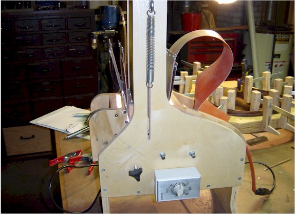

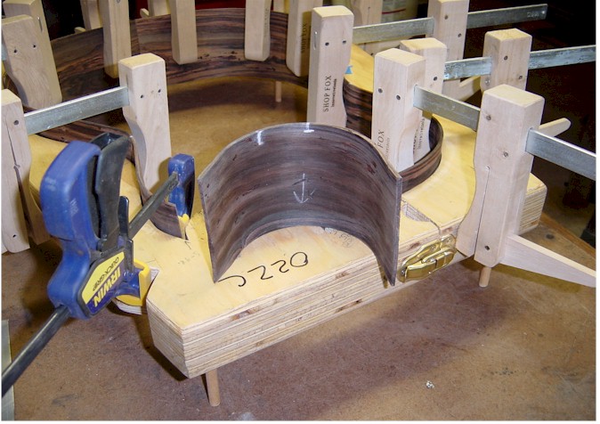

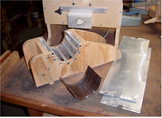

I don't know if anyone else has made this jig, but it works great! It's a mold that goes into the fox bender. I remove the 2 outer bulbs leaving just the middle one, and also use a blanket. I turn the blanket off after the press is completely down. Makes a perfect cutaway bend every time!

Great jig, i think i saw something similar on Dave Painter's website, i'll probably build one like this one soon, thanks for sharing Mark!
PostPosted: Wed Oct 25, 2006 2:33 am
That's pretty cool Mark! I was pondering the best way to bend one of those just the other day. Thanks!
